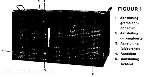

Philips - 2765 — Illustration 1

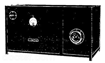

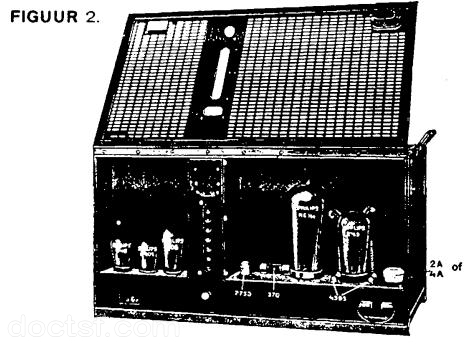

Philips - 2765 — Illustration 2Philips - 2765 — Illustration 3
